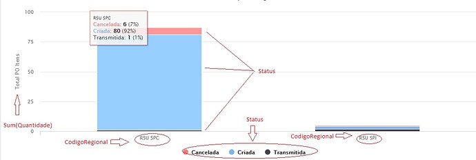

I need to use both, I need two metric(Status and CodigoRegional)
Then you’ll need to convert your string value to numeric.
I need to do something like this
That’s not supported. The closest you can come is to use X-Axis mode=series, see documentation, and something like this:

I’m already using X-Axis mode=series with one field in Group by and it works, but I wanted to use these two fields. Anyway thanks for your help.
