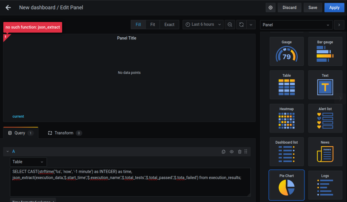

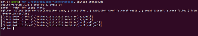

Hi, I have a sqlite database, which I would like to use as a data source for my grafana panels. My table in sqlite has a column called execution_data which stores a json object. I have installed sqlite plugin (SQLite plugin for Grafana | Grafana Labs) and setup the data source in grafana. Issue here is when I try to access the values inside json object of execution_data column form terminal it works fine (shown in finding values from json field.png). But, when I try to get the same values from grafana query editor it is showing that there is no function called json_extract (shown in json error in grafana.png).
Is there any way to deal with json objects present in the database using this plugin or any other plugin?
