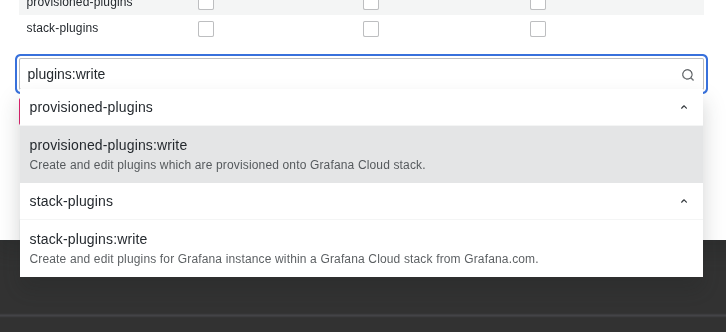

which is probably because i don’t have the correct scope selected to perform the signing. What do I have to select / how to fix this?

thanks for your reply. I did look/search for it, but I can’t find it. There’s only provisioned-plugins:write and stack-plugins:write, but no plugins:write. I tried adding both and giving access, but it doesn’t work

Oh, in the Realms Combobox I had “develdoc” selected but when I open the dropdown it offers me the option “develdoc (all stacks)”, which is different. With all-stacks the plugins:write scope appears.
If I open the box again I can only select “develdoc” and the plugin scope is gone again. It’s effectively switching between all stacks and not all stacks. That’s a bit weird, if they are 2 different things I would have expected 2 options in the list.
I checked the plugin:write scope, tested it and my plugin was signed successfully.
