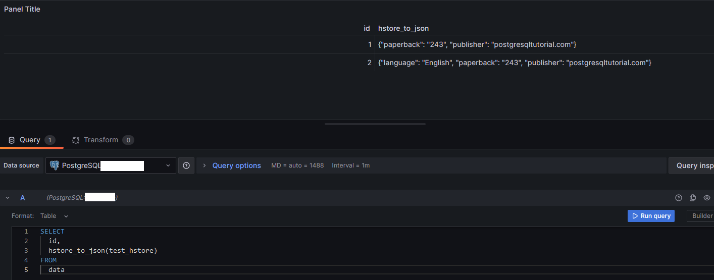

Hello,
try converting the hstore to json using the function hstore_to_json like this:
SELECT
  id,
  hstore_to_json(test_hstore)
FROM
  data
And then in the section Transform, look for “Extract Fields”, select the json column and keep the format as Auto.
You can then override the json column and hide it.
Awesome this worked thank you @clevernessisamyth
Although looks like the hstore stores the integers as strings and have to add one more transform to transform the fields. Is there a way i can avoid the seconds transform.(can hstore keep the values in intergers?)
@dparab Nevermind, I didn’t read the full hstore to json documentation x)
Just use hstore_to_jsonb_loose instead of hstore_to_json, and everything will work fine.
