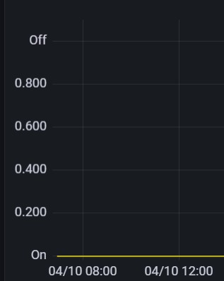

Hi, yes, I currently use it, but it causes side effects to graphs, like decimal values in timeseries, or weird min/max in state timeline. This doesn’t happen with native bool values.
timeseries
timeline
