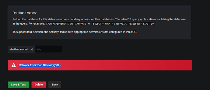

I am using the grafana hosted on the one server and I am using the Influxdb as a datasource which is hosted on the another server.While adding the datasource I am facing the 502/401 error. Also the both servers are not exposed to internet.
1.image|391x500
2.image|690x125
can anyone helpme on this

i have added the Influxdb IP address and added the db name and credentials as well
1.image|351x500
2.image|690x295
Now you have the wrong port number.

same 502 error
as per your suggestion i have changed the port and tested still its showing the same error.
And I forget to mention that the servers that I am using are not exposed to internet.

I could see only the grafana server are not able to ping the influxdb server. But in the reverse manner i tried influxdb is able to ping the grafana server.
That suggests to me that your InfluxDB server, or some router between it and
yoour Grafana server, is running a firewall which is allowing connections out
from the InfluxDB machine (and corresponding replies back again) but is
blocking inbound connections to the InfluxDB machine from the Grafana server.
