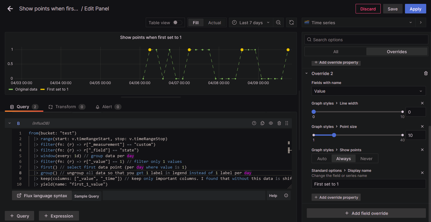

I solved this by first grouping data per day with window() function, then filtering data where value is 1 and after that selecting first data point. First data point is per each day and where value is 1 (since we filtered data that way).
Query:
from(bucket: "test")
  |> range(start: v.timeRangeStart, stop: v.timeRangeStop)
  |> filter(fn: (r) => r["_measurement"] == "custom")
  |> filter(fn: (r) => r["_field"] == "state")
  |> window(every: 1d) // group data per day
  |> filter(fn: (r) => r["_value"] == 1) // filter only 1 values
  |> first() // select first data point (per day where value is 1)
  |> group() // ungroup all data so that you get 1 label in legend instead of 1 label per day
  |> keep(columns: ["_value", "_time"]) // keep only important columns. I found that without this data is shifted.
  |> yield(name: "first_1_value")
Result:
On left you can see table with times when value was set to 1 first time in day. On right there is a graph where dashed line represent Original data and yellow dots represent points where value is set to 1 first time at that day. Note that at first day (4.6.2023.) value went to 1 two times (at 6h and at 18h) but only first time is kept. Table uses same query as in graph.
Pictures with queries and set overrides
Query A is used to show original data (dashed green line).
Query B is used to showed yellow points which represent times at which value was set to 1 first time per each day.
Best regards,
ldrascic
