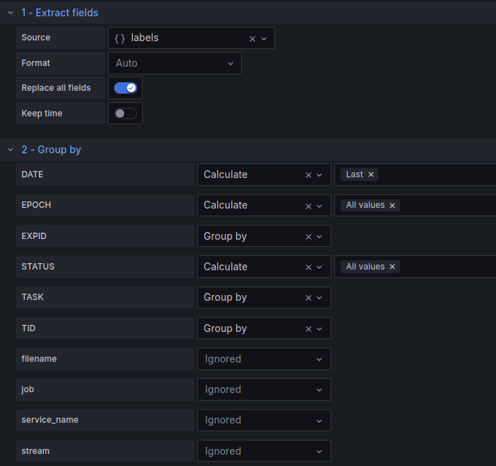

Hello there,
If this is what you wanted, follow the steps :
*Logs used :
Use this query to get only the logs that has the label STATUS, and only the values START and END :
{job="test"} |= "STATUS" |~ "START|END" | pattern `<DATE> TID=<TID> EXPID=<EXPID> TASK=<TASK> STATUS=<STATUS> EPOCH=<EPOCH>`
Then, do these transformations :
  1. Extract the labels to field.
  2. Group by the IDs and get the “All values” of the EPOCH, STATUS and the "Last
    value of the DATE (“Last” is the date of the task with STATUS=START).

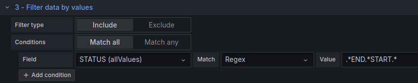

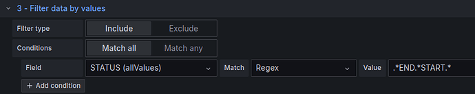

  1. Filter out the lines to retain only the tasks that succeeded (have both END and START status).
