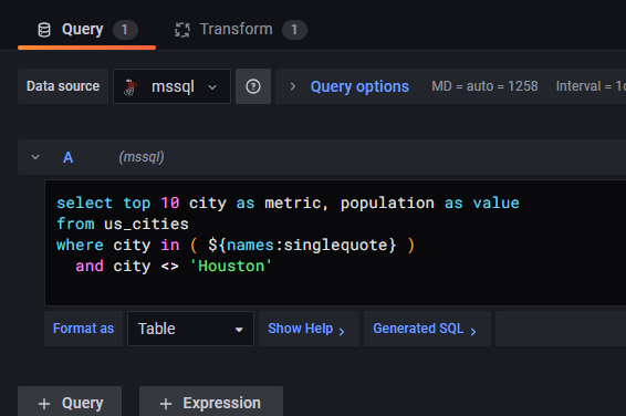

maybe this. Manual and static but might do the job

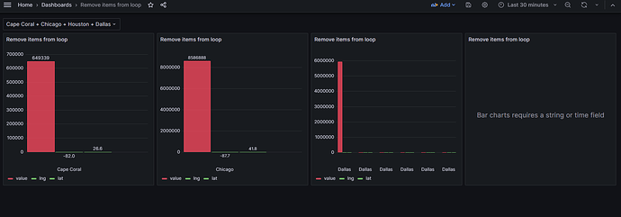

But that will produce the following which will be an issue
The last empty panel is for Houston, which is available in drop down (if you have a drop down) but is excluded in the query.
