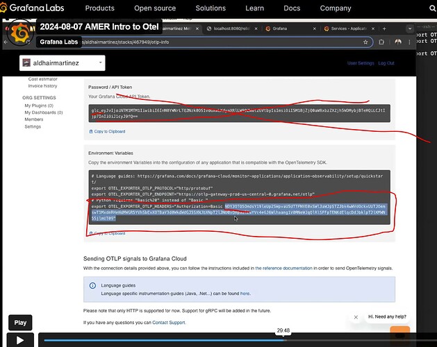

Now it’s time to share your credentials, pls. What was used in that webinar?
Rewrite that NDY... value into text and make base64 decode. What will be the result?

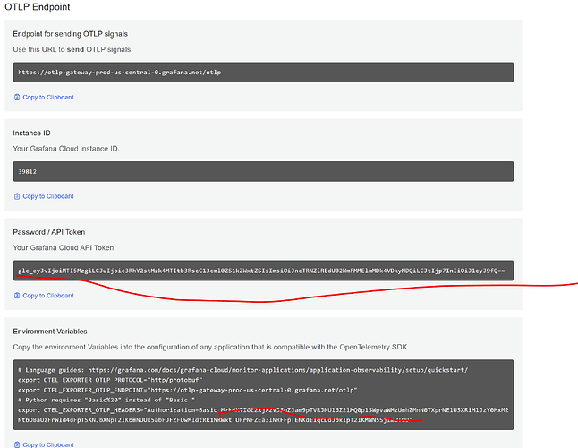

Sorry, you don’t understand. Follow pictures:
API token (BTW it’s JWT read RFC 7519):
glc_eyJvIjoiMTI5MzgiLCJuIjoic3RhY2stMzk4MTItb3RscC13cml0ZS1kZWxtZSIsImsiOiJncTRNZlREdU02WmFMMElmMDk4VDkyMDQiLCJtIjp7InIiOiJ1cyJ9fQ==
Instance ID:
39812

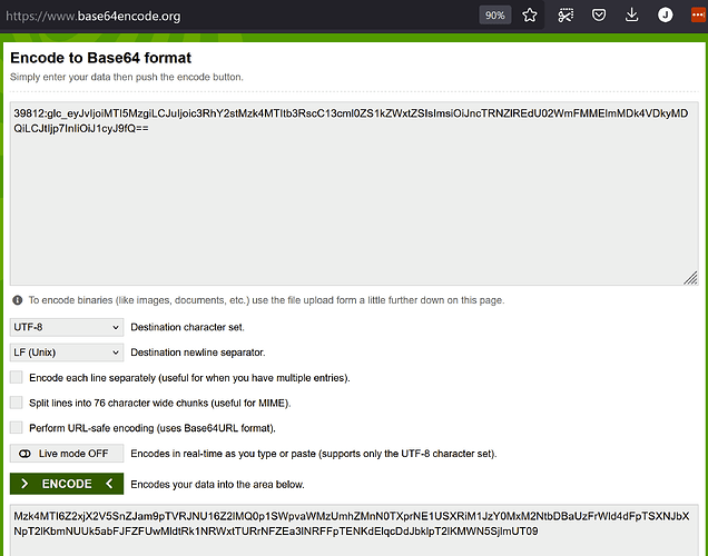

So basic auth header will be base64(instance ID:API token) - read RFC 7617:
So what will be basic auth header?
What was used in the referred webinar?
So what will you get when you use API token instead of base64(instance ID:API token) in basic header?
