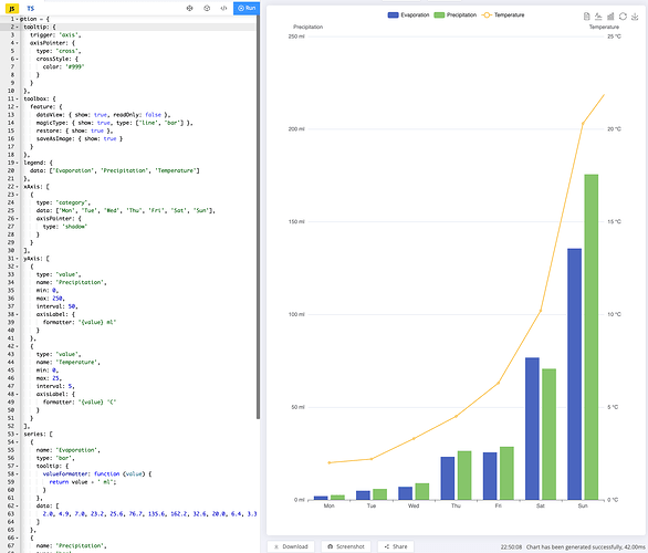

@omar251998 If the standard Bar Chart does not work for you, I would recommend looking at the Apache ECharts plugin.
Here is the example of how to do it: Examples - Apache ECharts
