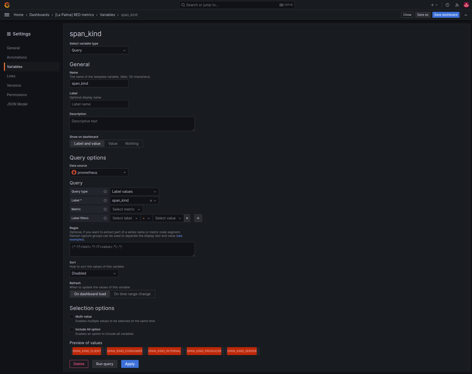

I have a query variable in a dashboard.
My query returns the values of the label “span_kind”:
- SPAN_KIND_CLIENT
- SPAN_KIND_CONSUMER
- SPAN_KIND_INTERNAL
- SPAN_KIND_PRODUCER
- SPAN_KIND_SERVER
However, what I need it to add a prefix “APPLICATION” to all values. For instance:
- APPLICATION_SPAN_KIND_CLIENT
- APPLICATION_SPAN_KIND_CONSUMER
- APPLICATION_SPAN_SPAN_KIND_INTERNAL
I tried using regex, but it seems it can only filter, but not replace.
Thanks in advance
