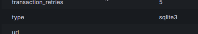

After trying ~ 3 times, I haven’t been able to get the server to successfully recognize that it should be going to MySQL I am unsure what I should do at this point. With that it also keeps saying in the settings of the web interface that I should restart the server to apply the changes, even after doing so.
We have zero insight/context as to how you configured your settings
please share your grafan.ini etc
