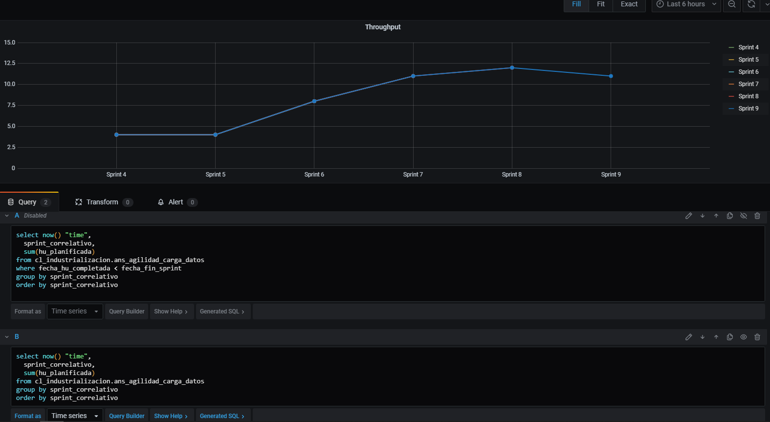

Hi, I try to make two lines show at the same time, but the result is not what I want, it is putting them one after the other making only one line and I need to show the two separately.
this is what it shows me together
this is what it shows me separately
this is what i want to show me

Hi,
It’s not possible to do this right now for non time-series data as the “Series” Mode for the X-Axis and the “Stack” options are not compatible. There is an issue open about this here: https://github.com/grafana/grafana/issues/7949 (you can add your thumbs up to push this feature)
