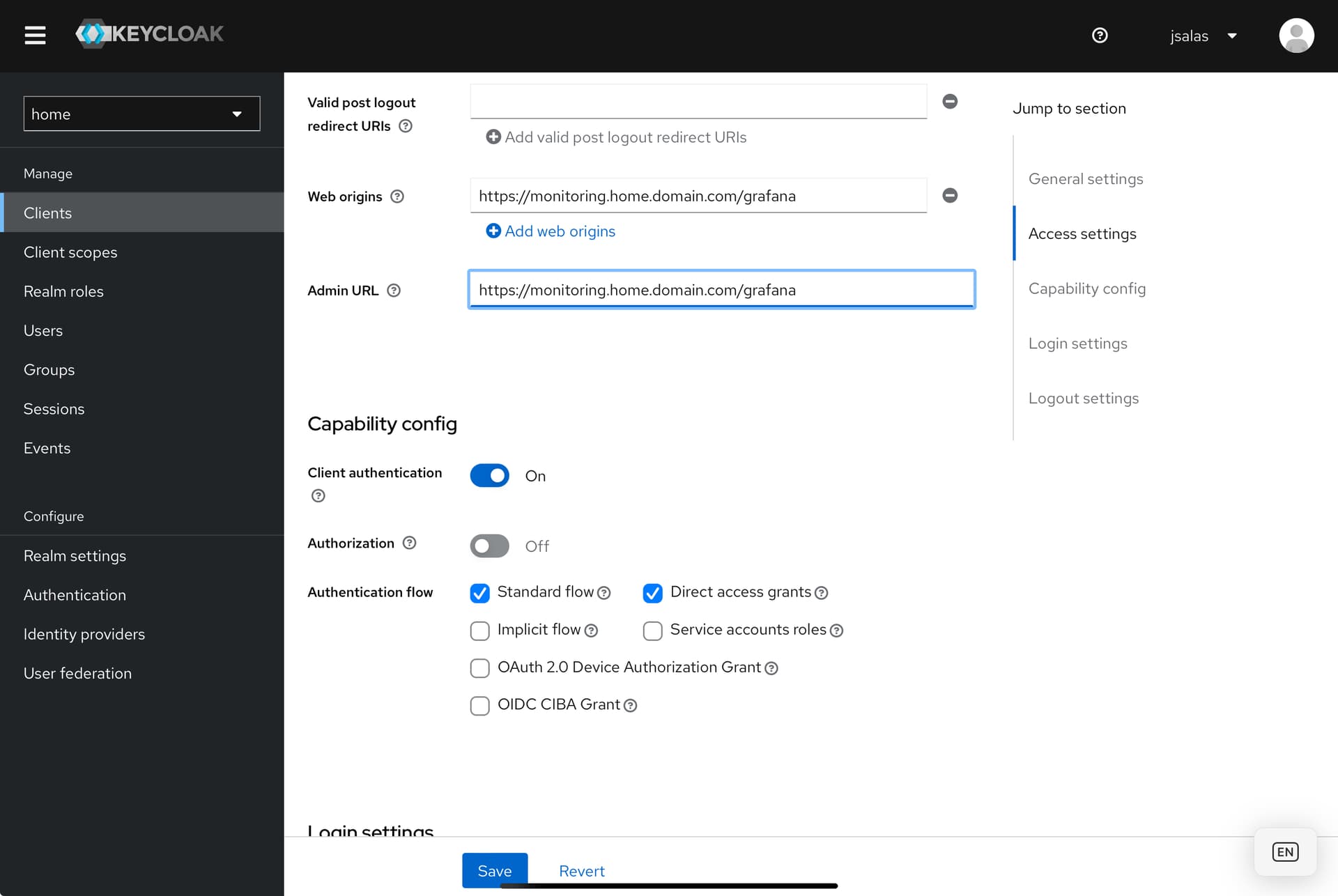

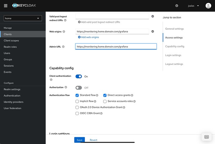

  • Client config in Keycloak

I don’t know if it’s right, but I disabled Client authentication and it worked.
use_pkce
Added, but…
logger=context userId=0 orgId=0 uname= t=2024-04-18T19:01:00.810516491Z level=info msg="Request Completed" method=GET path=/login/generic_oauth status=302 remote_addr=10.244.0.0 time_ms=0 duration=592.658µs size=439 referer=https://monitoring.home.domain.com/grafana/login handler=/login/:name status_source=server
logger=authn.service t=2024-04-18T19:01:02.803233017Z level=error msg="Failed to authenticate request" client=auth.client.generic_oauth error="[auth.oauth.token.exchange] failed to exchange code to token: oauth2: \"unauthorized_client\" \"Invalid client or Invalid client credentials\""
logger=context userId=0 orgId=0 uname= t=2024-04-18T19:01:02.840936833Z level=info msg="Request Completed" method=GET path=/login/generic_oauth status=302 remote_addr=10.244.0.0 time_ms=101 duration=101.597105ms size=37 referer= handler=/login/:name status_source=server
But that’s not just use_pkce: true - you need public client in the Keycloak, you need to remove client secret/GF_AUTH_GENERIC_OAUTH_CLIENT_SECRET in Grafana, …
You should mention what is “Client authentication”:
When client is public, then PKCE must be used.
