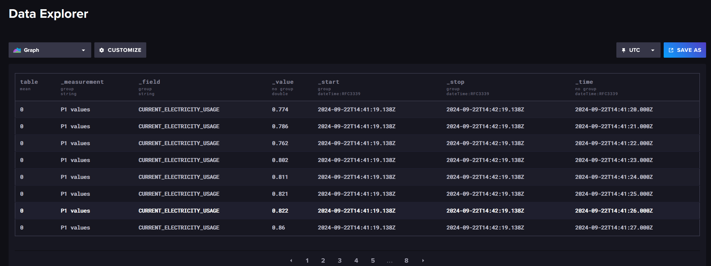

is your timestamp in your data UTC?
UTC, I think, based on the fact if I run the query in Influx Explorer I get the following results:
