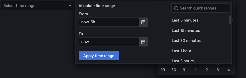

The problem I am facing is that the TimeRangeInput component seems broken and not interactable. Let me explain :
Here is the component in itself in my project
Here is the component when I click on the agenda and it opens the calendar (i can’t interact with it)

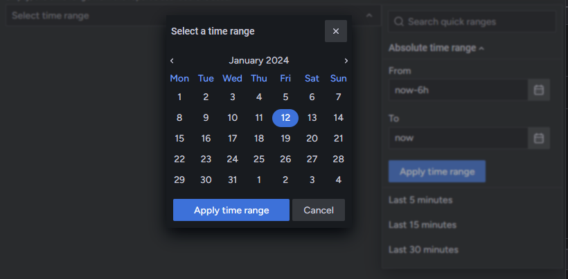

Here is the calendar in the responsive mode on a small screen (it works)
So to summarize, I can’t interact with the calendar component in the TimeRangeInput, unless it is in responsive mode.
What i have tried :
I tried to set the “isReversed” option to false, I can see the calendar better, but it is still not interactable.
At first I thought the issue came from my own css file, but I tried to delete my whole css, refreshed the plugin (without any cache) and it still didn’t work.
The code i am using is litteraly the one used in the Grafana storybook, and the value types are correct.
