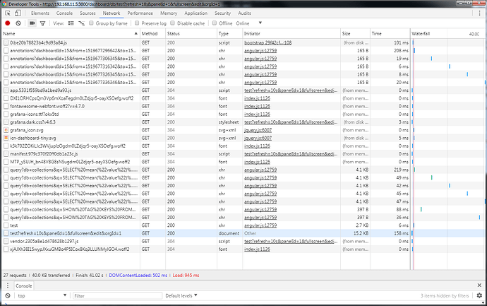

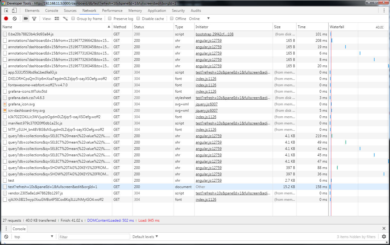

Thanks. Please check chrome dev tools -> network tab when you expand the drop down and inspect the request/response of the http request. Maybe it’s taking some time for that query to complete and/or it timing out.
Marcus
Yes good point, looks like I have all 200 and 304 status, total load 872ms, console also doesn’t list anything. All connections to the grafana server (that is acting as proxy to the influxdb)
