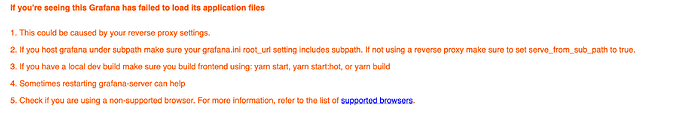

Hi there. I am trying to deploy grafana through a docker-compose.yml file
grafana:
image: grafana/grafana
depends_on:
- prometheus
ports:
- "3000:3000"
env_file:
- .env
volumes:
- grafana_data:/var/lib/grafana
networks:
- main
.env
GF_SERVER_ROOT_URL='grafana.somedaomain.xyz'
And this is how my nginx config looks like
server {
listen 8080;
server_name grafana.*;
root /usr/share/nginx/html;
index index.html index.htm;
location / {
proxy_pass grafana:3000;
proxy_max_temp_file_size 0;
However I cannot access it through my domain, I tried to test it locally by adding a new entry in my /etc/hosts but nginx just gives me a 502 Bad Gateway and community.grafana.com results in the following message from grafana.
I’m not entirely sure how this should be fixed though.
