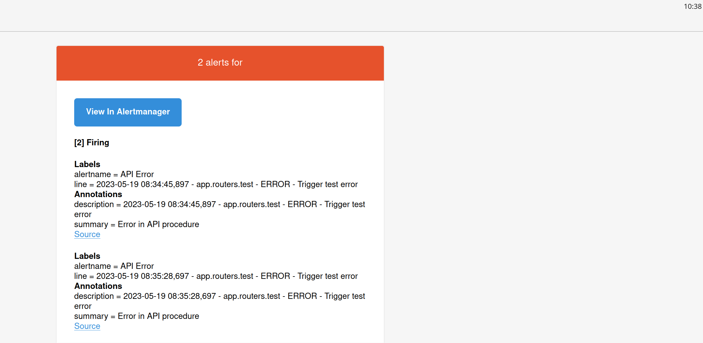

I fired two test errors and received two notifications for every error.
Errors in Grafana UI:
First mail received with the alerts (I included the received time in the top right, 10:36)
Second mail received with the same errors again, 2 minutes later:
Based on what you wrote earlier, I see the “line=…” label now, but I posted the complete yaml above, so I don’t know where this comes from.
Thank you!
Hi! :wave: Thanks for the screenshots! I think I understand where the confusion is here.
I think this is working as intended. You are asking Grafana to create an alert for each ERROR log. If I look at the screenshots Grafana is doing just that. You have two alerts: the first alert is for an error log at time 2023-05-19 08:34:45,879 and the second alert is for a different error log at time 2023-05-19 08:35:28,697.
I think the question is then why does each email contain both alerts? The answer is because that’s how grouping is configured in your Alertmanager configuration. If you want one alert per email you’ll need to disable grouping by changing it to Disable (...).

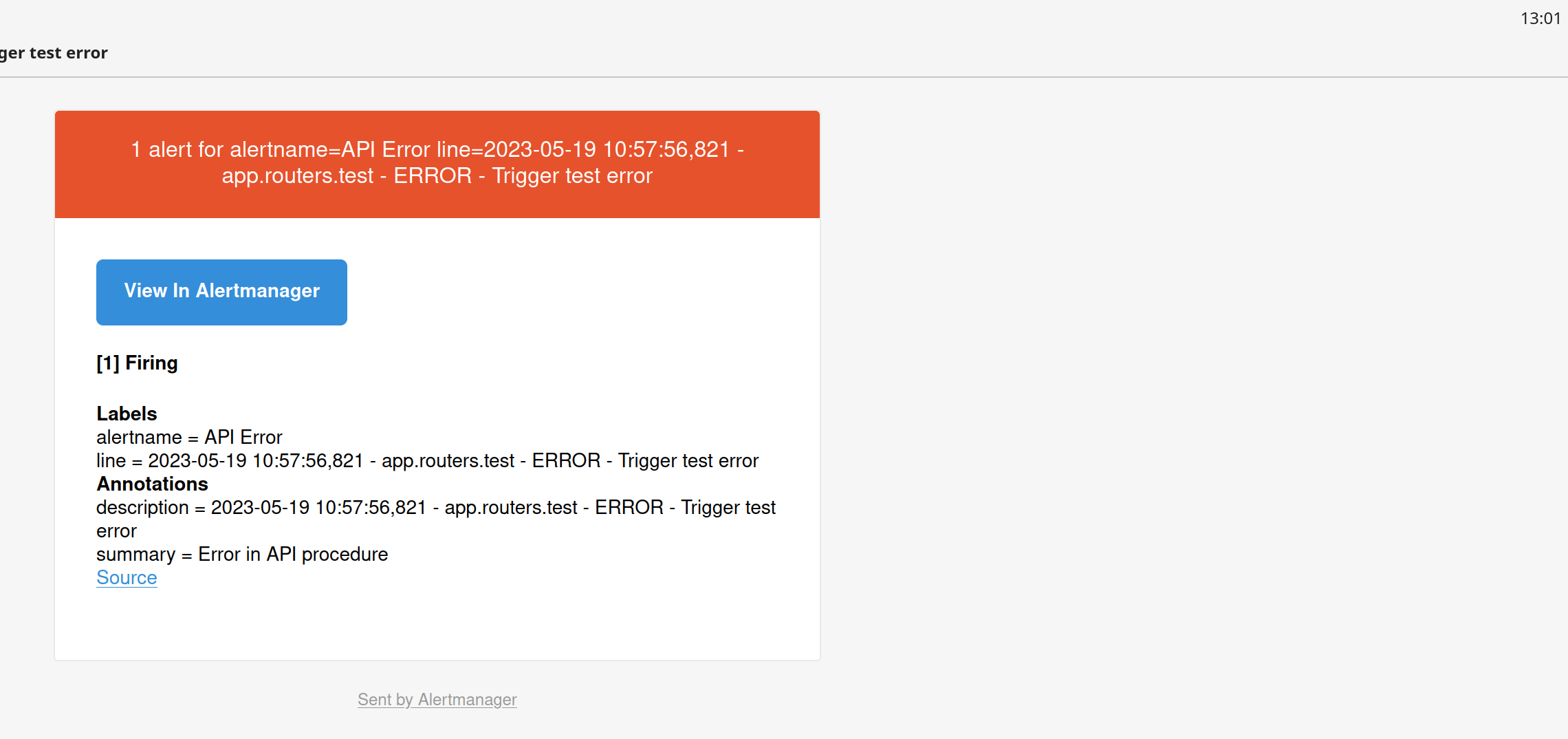

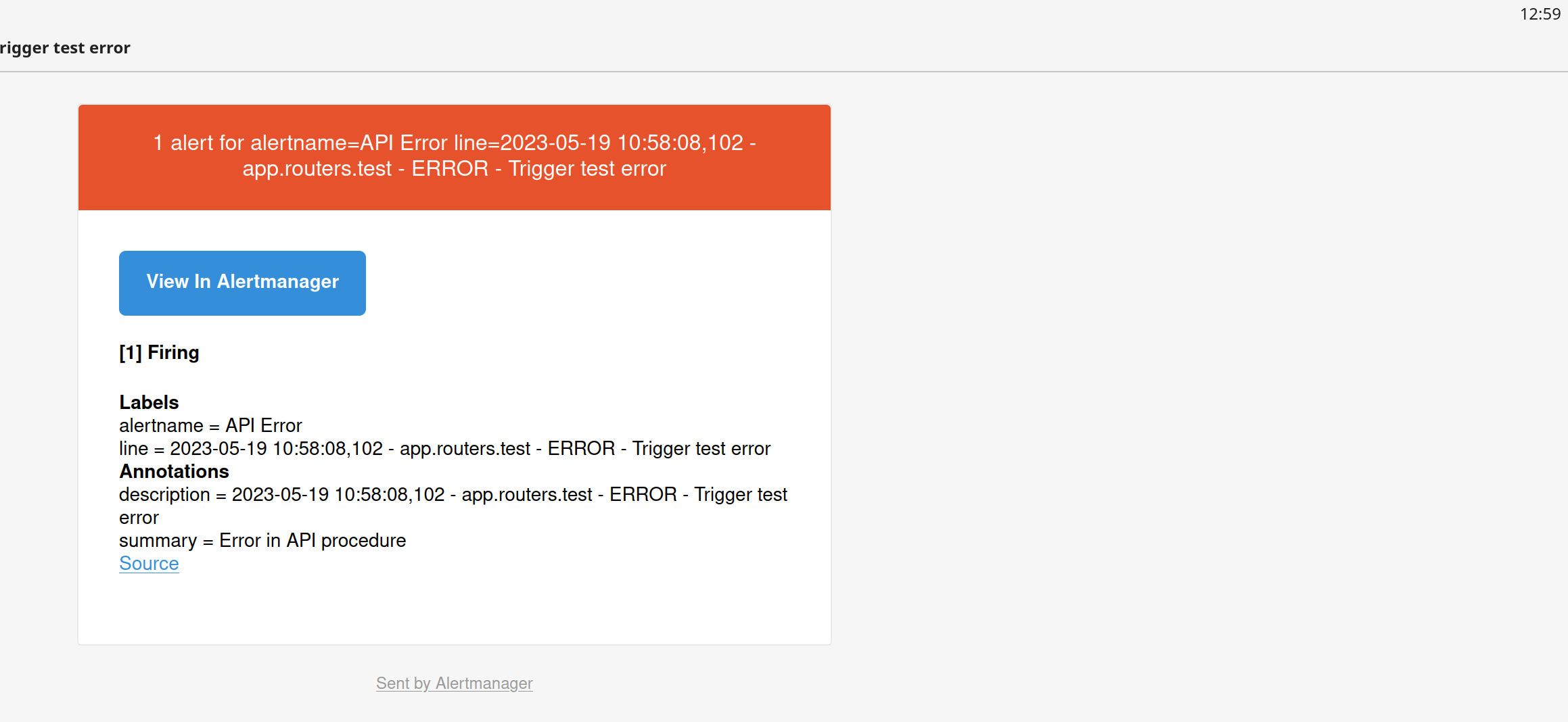

Hi George,
I’ve disabled grouping, and I still receive multiple notifications per alert:
I again triggered two error logs.
Two instances are firing:
I get 4 emails:
Mail 1: alert 1, sent 12:59:
Mail 2 alert 2, sent 12:59:
Mail 3: alert 1, sent 13:01:
Mail 4: alert 2, sent 13:01:
It’s completely possible that our config is wrong somewhere, but from my current understanding we shouldn’t get multiple notifications.
Thanks!
