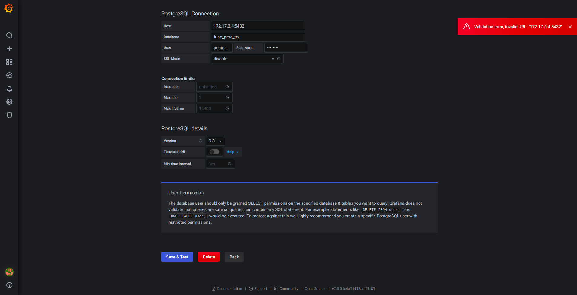

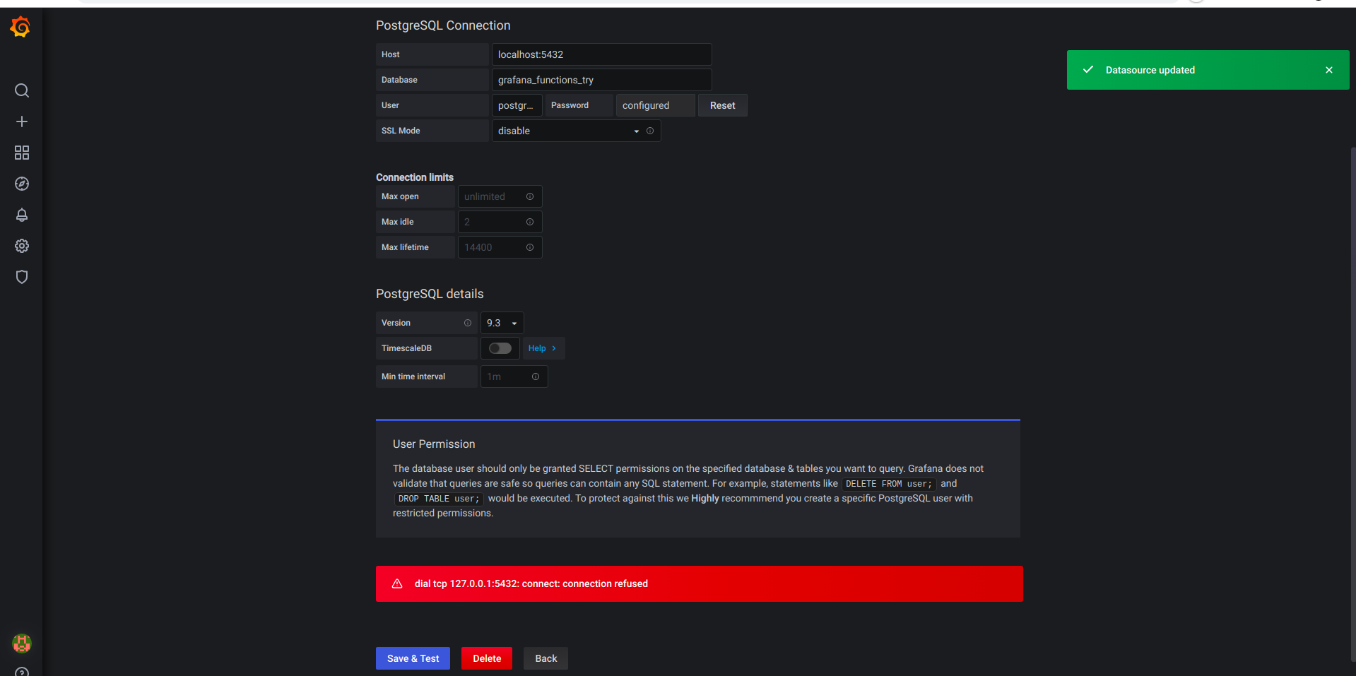

I try new grafana 7.0.0-beta1 version. And I find diffcult to connect the PostgreSQL. I am run postgres in docker. In Host I tried giving both localhost and docker ip(172.17.0.*). but it’s working fine in stable version ( * v6.7.3 (a04ef6cefc))
And I am attaching the image for your reference.

Are you running Grafana on Docker too? It could explain why ‘localhost’ is not working.
For the second error, an issue was created here: https://github.com/grafana/grafana/issues/24387
You can put a thumbs up or comment to say that you face the same issue. I could reproduce it on 7.0.0-beta1 but not on master so it should be fixed on the next release.
