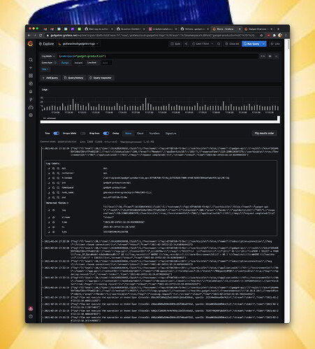

Hi folks – I have a promtail agent set up in my Kubernetes cluster correctly forwarding logs to my Grafana Cloud Loki instance. I switched away from using an unmodified Grafana Cloud Agent deployed via helm to an unmodified Promtail instance deployed via helm, and now my log entries are being wrapped in a {"log": "{\"my\": \"log\"}", "time": ...} wrapper.
The wrapper makes it kind of hard to read in Grafana and the inner json seems to have been string escaped. Is there a way to turn off this wrapper at the promtail level, so the raw JSON is the log entry in Grafana, without using a LogQL query every time?

See an example here

That wrapper you are seeing isn’t added by the Agent, rather that’s the normal log output created by docker
The good news is this would be applied to every log line in your kubernetes cluster as your container runtime must be docker.
The best way to handle this is to add the following pipeline stage:
-docker:
documentation here
This is basically some syntactic sugar to unwrap that json and then output your original log line.
We also have a
-cri:
Stage which can handle containerd runtimes if your Kubernetes isn’t running docker.
cri documentation here
Ah ha, that makes all the sense in the world! My guess is the grafana cloud agent config I was running with had that docker pipeline stage in it and the new helm chart one doesn’t include it by default. I will add that. Thanks so much for the tippy!
