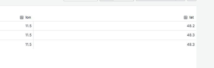

geomap needs longitude, latitude, you need to extract those values from that data you posted.

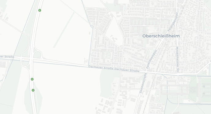

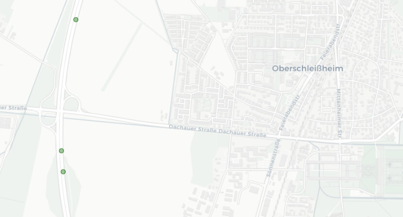

but does this change dynamically also?
"type": "linestring",
"coordinates": [
