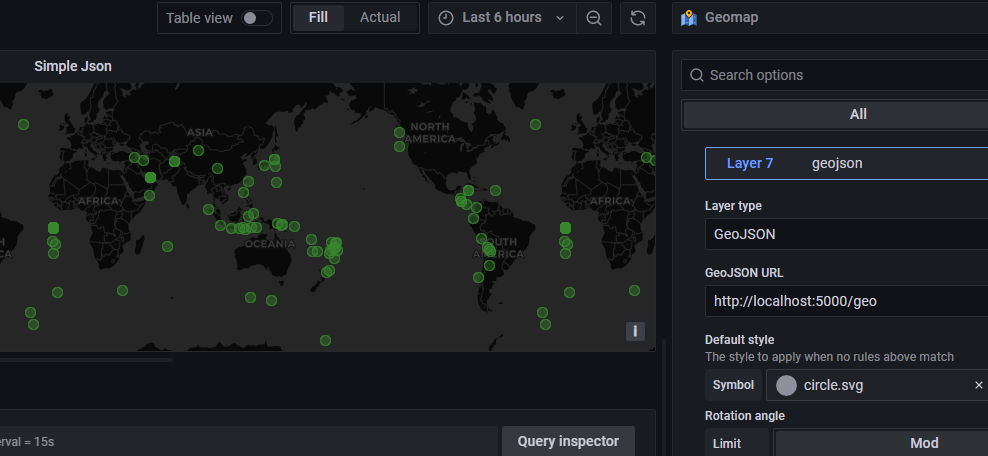

here is one simple approach by creating a small nodejs express api
this example is for a file on disk, but the options are endless, you can plug in your db etc.
const express = require('express')
const cors = require('cors');
const bodyParser = require('body-parser')
const parse = require('csv').parse
const mysql = require('mysql')
const fs = require('fs');
const fetch = require('node-fetch');
const FormData = require('form-data');
const app = express();
const port = 5000;
require('dotenv').config();
app.use(bodyParser.json())
app.use(express.static('public'))
app.use(cors());
app.options('*', cors()) /
app.get('/geo', (req, res) => {
let rawdata = fs.readFileSync('./data/earthquakes.geojson');
let geo = JSON.parse(rawdata);
return res.json(geo)

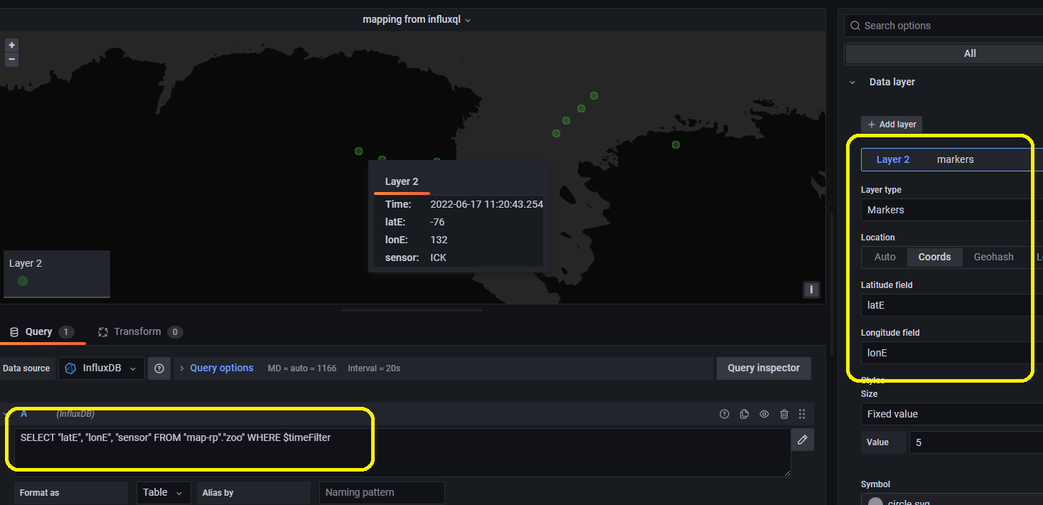

using your data with influxql
SELECT “latE”, “lonE”, “sensor” FROM “map-rp”.“zoo” WHERE $timeFilter
Grafana is treating sensor as a column, but it is a tag.

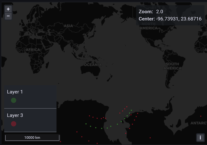

Here are my definitions for my layers:
Here is the resulting Geomap:

Please note that on GeoMap there is data for only for (lon,lat) and (alon, alat); there is no data for (lonE,latE). This is clear that no layer 4 is displayed, and there is no heatmap data. (Heatmap was chosen only because it would stick out more. It doesn’t show up no matter what I change it to.)
On the Time Series there is data for all three pairs.
I expect GeoMap to have 3 layers, and time series to have 6 traces. GeoMap has only two layers although three are defined.

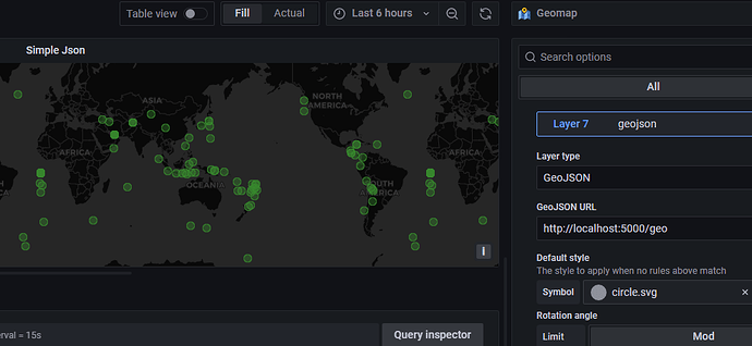

So here are 2 items plotted
one geojson, the other csv long lat data
the reason you might not be seeing heatmap because it is layered on top of same long lat

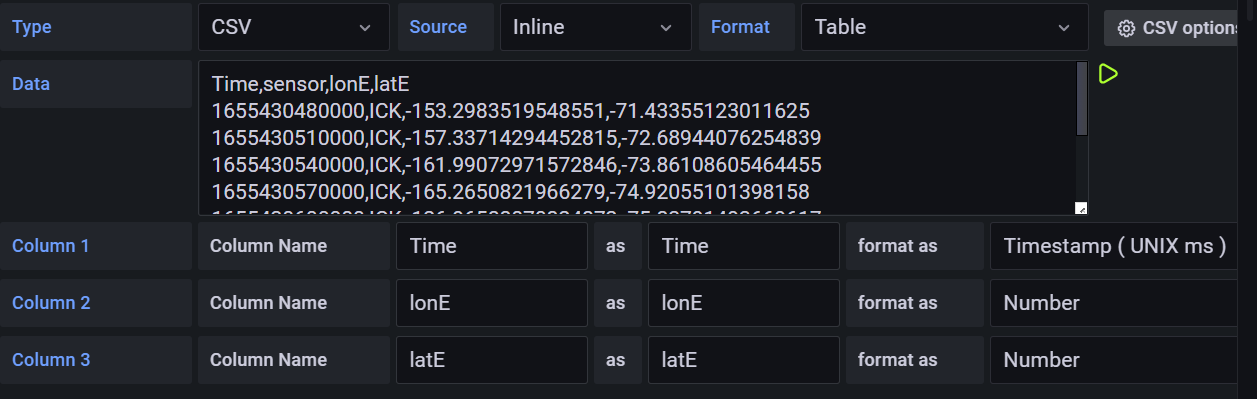

On your chart try this:
Create an infinity/csv/inline data set using the csv text provided above (editing out the " )
Create a second query “B” using the second CSV above
Now create three layers from this data. layer1 for lat/lon, layer2 for alat/alon, and layer3 for latE,lonE.
Note that layer 3 does not show up.
Remove query A
redefine layer1 to be latE,lonE.
Note that it does show up.

          "columns": [
              "selector": "Time",
              "text": "Time",
              "type": "timestamp_epoch"
              "selector": "lonE",
              "text": "lonE",
              "type": "number"
              "selector": "latE",
              "text": "latE",
              "type": "number"
          "data": "Time,sensor,lonE,latE\n1655430480000,ICK,-153.2983519548551,-71.43355123011625\n1655430510000,ICK,-157.33714294452815,-72.68944076254839\n1655430540000,ICK,-161.99072971572846,-73.86108605464455\n1655430570000,ICK,-165.2650821966279,-74.92055101398158\n1655430600000,ICK,-126.96588070824872,-75.83791493669617\n1655430630000,ICK,11.231682525086336,-76.58901830737138\n1655430660000,ICK,156.49409720489774,-77.14520677878559\n1655430690000,ICK,163.89762502154053,-77.47190545446718\n1655430720000,ICK,155.39441446038967,-77.55173288216504\n1655430750000,ICK,146.91699169635038,-77.37843108588937\n1655430780000,ICK,138.9020904474493,-76.96493761096185\n1655430810000,ICK,131.55274206070735,-76.33456319656624\n1655430840000,ICK,,",

It doesn’t show up :cold_face::exploding_head::scream:
A-hah! It isn’t just me! Finally figured out how to distil the problem down to a testable, portable, actionable bug report! Woooo! I deserve a cookie!
Why didnt you say so in first place :joy:
Can you try to offset the long lats a bit. Maybe same coordinates being overlaid one on top of other cancels one out
Deep breath…
It isn’t the close data points. (if it was, that would be a bug too.)
Consider the following. The first has its data in a single “query”, the second has it split between the two. That’s it. The first one displays two layers, the second does not.
I don’t think I can meaningfully provide a simpler example of the bug.

We do thisvia nodejs/express rest api and use another geomap plugin
Se my example here
You can of course make it read from a database also
