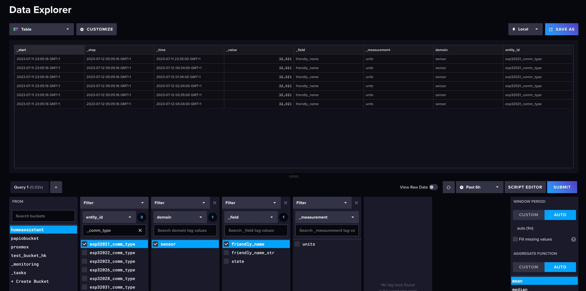

hi @grant2 , thank you for your answer.
all entities (for 1 device: esp32033) are on the picture below
and i.e. I would like to see let it be RSSI but only of these sensors, that have as *_comm_type LoRa or ESPNow - or any other case where I want to see the value of entity1 while filtering by the value of entity 2

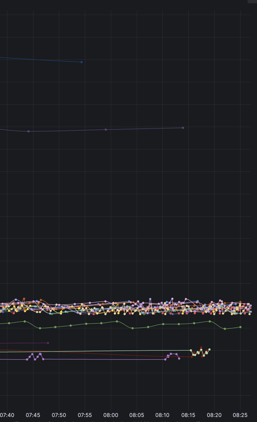

So my goal is to create 2 different graphs: 1 for LoRa and 1 for ESPnow.
Reason being: LoRa communication (so working_time_ms) is way longer than ESPnow (LoRa is about 1000ms while ESPnow is about 200ms) so having both types o sensors in 1 graph makes the graph a bit invisible (as the graph gets extended vertically due to large values coming from LoRa sensors)
I hope that clarifies.
See on the screen shot the difference between majority being ESPnow (low values) vs the few ones that are LoRa - much higher values. This way the lower part of the graph is not really readable:
THANK YOU FOR YOUR HELP!

I realised that the sensor.esp32094_com_type does not land in the influxdb - it does not have unit, the value is text type so probably this is the reason why I am not able even to see the values in the db so obviously in Grafana as well.
See above: what is value of “32021”? that should be “ESPnow” rather, as the sensor really is in Home Assistant:
but there is no “unit” for this sensor, so I think this is the problem.

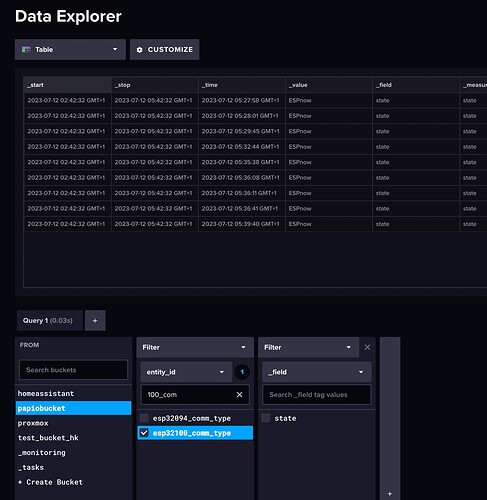

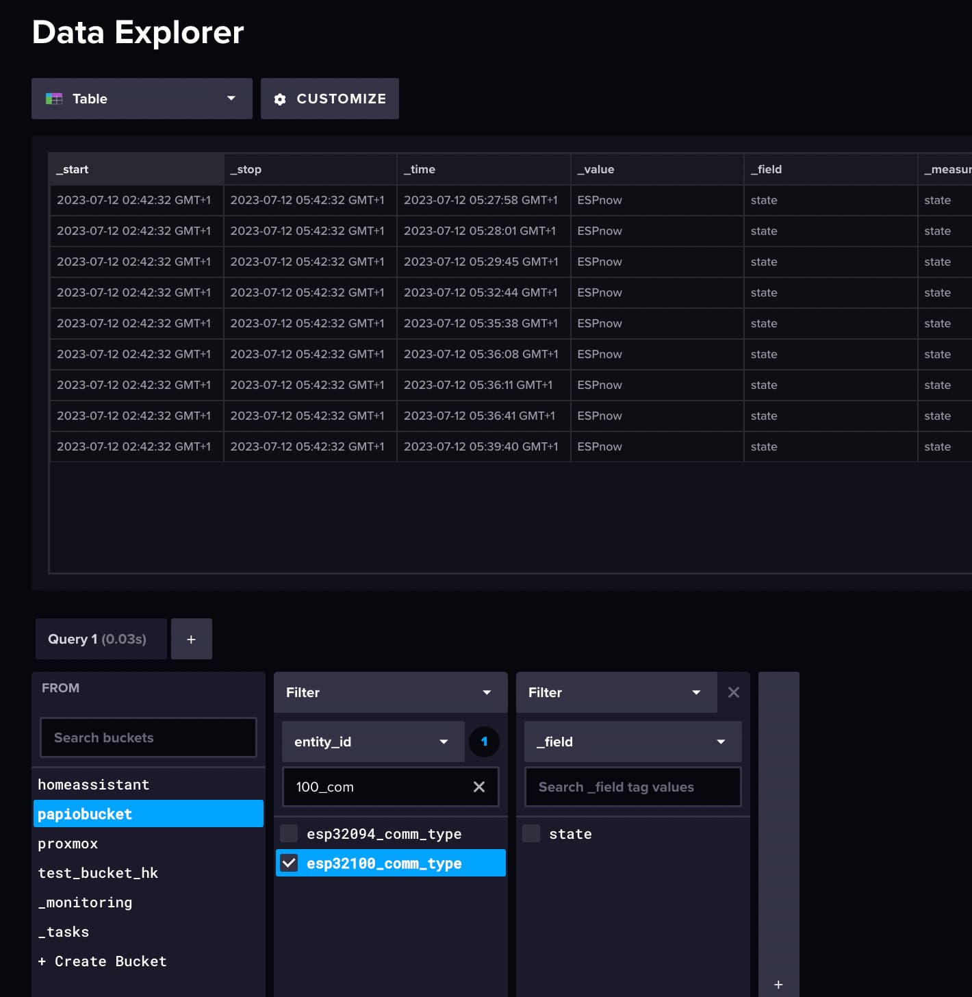

the outcome is promising - I can see in influxdb now the values of _comm_type:
LoRa for device: esp32094
and ESPnow for esp32100:

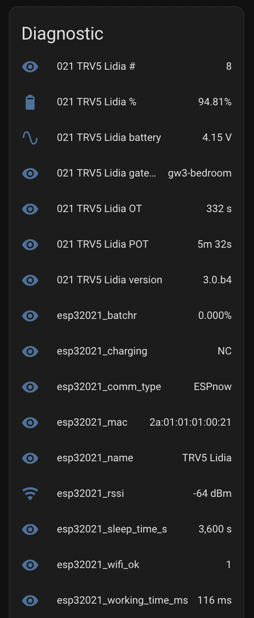

Apart from the “useful” data (temperature, light, humidity, motion etc.) there are some other sensors that are for “admin purposes” such as:
  • battery status: Volts, % etc.
  • RSSI
  • time the sensor was online “work_time_ms” (in ms)
As you can imagine both RSSI as well as work_time_ms are completely different for ESPnow devices (very fast communication, worktime in range of 100ms to 300ms depending on the number of sensors in it) while LoRa devices have worktime few times longer.
Similarly for RSSI: ESPnow devices will have range of -25dBm to -90dBm (below that they die), while LoRa devices will go up to -135dBm before they die.
To distinguish the type of communication, every sensor device sends also one more information: communication type. I am using the sensor called: sensor.xxxx_comm_type
It is text value type and can be: “WiFi”, “ESPnow” or “LoRa”.
