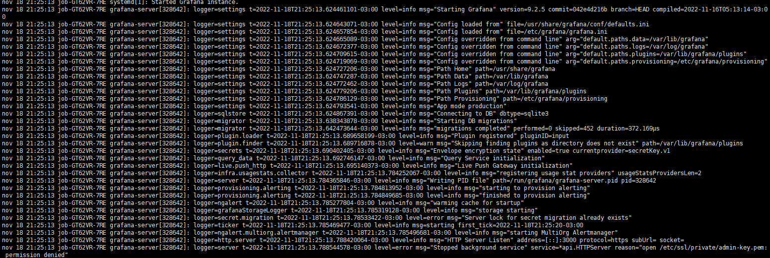

I’m finishing a configuration for SSL certs in order to grafana uses TLS/SSL, and I got the following error on an attempt to start the service via systemctl
grafana-server[330353]: logger=server t=2022-11-18T21:44:04.365832806-03:00 level=error msg=“Server shutdown” error=“*api.HTTPServer run error: open /etc/ssl/private/indexer-key.pem: permission denied”

Let me paste a complete message as picture below:
