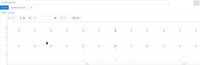

The problem is with the chart, when I first set this up, I was able to get a graph for the last 12 hours, but if going to a shorter interval no data was shown. It has now been two days thinking I should be able to go back for the last 12 hours or 24 hours and I now get no data for any interval I select for the chart.

Below is the picture for 1hour
If I go into prometheus I do not see any data for the last 6 hours but if I look at last 2 hours or shorter I do see data. Also why will prometheus not show any data beyond 2hours, the first day I was able to get 6 hours, now I do not even get that.
I would thought the chart would show something all the way up to 2hours (i.e last 2 hours, 1hour, 30 min, etc)
