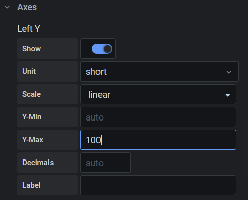

1)How can i fix an maximum value in Y axsis in a graph for an dashboard.
Ex : if i want to see the availability of a product it wont be more than 100% i want to fix the value as 100% in y axsis ,i can see the value goes upto to 140% while using the graph dashboard .

Hello,
To set a maximum value, you can set it in the “Axes” options. You have a ‘Y-Max’ field that you can set to 100 (you can find these options on the right panel if you are on Grafana 7 or in the panel below the graph otherwise):
