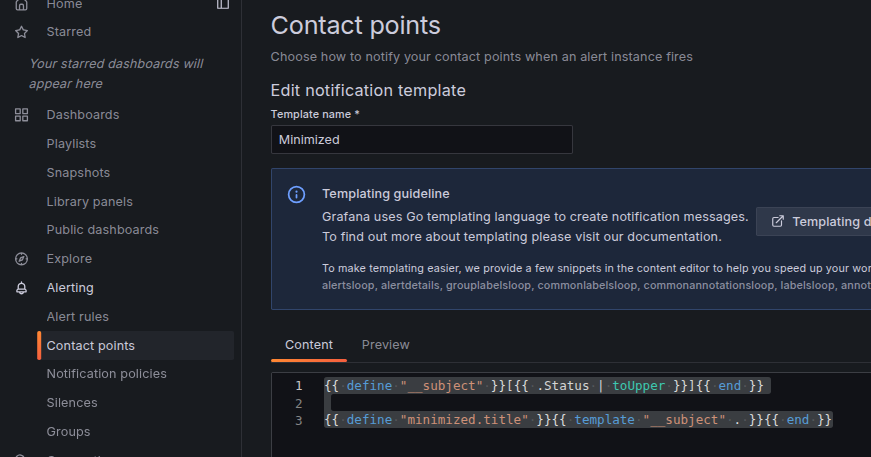

Under Contact points > Notification Templates I created a custom template based on the default template in main/templates/default_template.go:
{{ define "__subject" }}[{{ .Status | toUpper }}]{{ end }}
{{ define "minimized.title" }}{{ template "__subject" . }}{{ end }}
It works fine in the preview:
============================>[FIRING]<============================

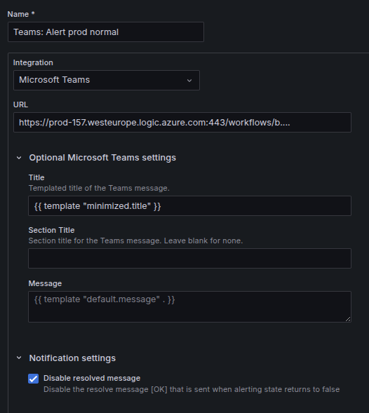

I add the template to the teams contact point like this:

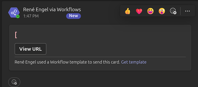

Then when sending a test notification via “Send test notification”, the Teams title is cut off:
I thought it might be that .Status is not set, hence an error occurs, so I added an if, still with the same result:
{{ define "__subject" }}[{{ if gt (len .Status) 0 }}{{ .Status | toUpper }}{{ end }}]{{ end }}
Anyone know what the problem is?
