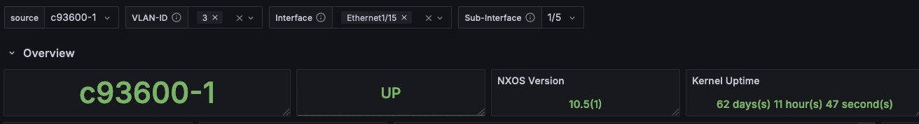

    I have a dashboard variable named source. It is populated based on a query which selects the available layer-2 switches which emit telemetry data. Sample variable value can be switch1, switch2 etc.
Corresponding to the two switches (mentioned above) I have 2 inifinity datasource setup. The dashboard is expected to display telemetry data for the switch indicated in the source variable when used as a query key in appropriate fluxv2 queries. An example snapshot can be seen below.
One of the (library) panels uses infinity datasource. I’d like to change this datasource based on source variable such that changing source e.g. from switch1 to switch2 will change to the corresponding infinity datasource so that appropriate information pertinent to that switch can be represented.

@dawiddebowski : 1st option fit my use-case as I could easily change the infinity datasource name to include results from the ${source} (as seen by screen shot below)
