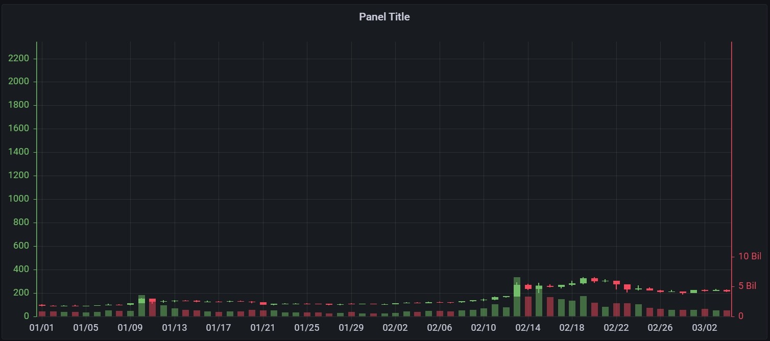

Hi, dear Grafana community!
    I’m using Grafana Version 9.3.1 (commit: 89b365f8b1, branch: HEAD) installed in Windows 10 WSL:
    5.10.102.1-microsoft-standard-WSL2 #1 SMP Wed Mar 2 00:30:59 UTC 2022 x86_64 x86_64 x86_64 GNU/Linux
    I’m trying to use candlestick panel in “Both” mode with simultaneous OHLC and Volume bars.
    I’m using query to ClickHouse DB directly selecting DateTime and OHLC+Volume fields.
  • What happened?
    OHLC and Volume are shown on the panel, but both of them have a very low scale (both graphs occupy about 1/5 lower part of the working filed, the rest upper part of the field is empty) and have the same zero level and intersect with each others. Possibly, there is an error in calculating upper bound of the Y-axis in “Both” mode. In separate “Candles” and “Volume” modes scale is correct.
    I expected to see a much higher usage of Y-axis in “Both” mode of candlestick panel.

Welcome

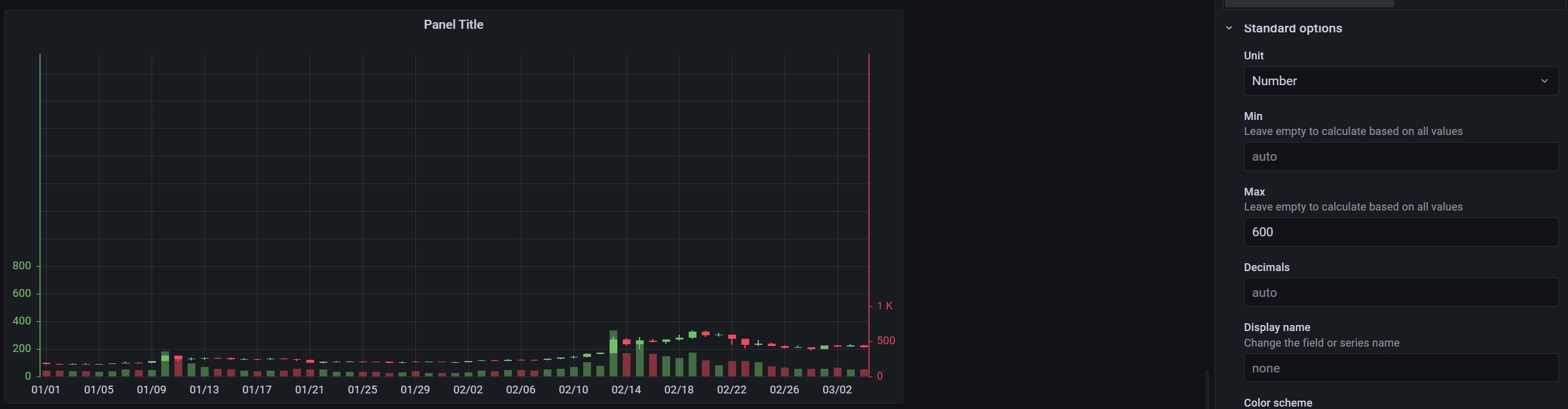

On the right side of your dashboard, you should find min,max settings. You can search min or max in the search box of panel config. Maybe it has a default setting you can change there
But also notice your right and left y axis. One is low 5 digit , right one is billions?
Hi yosiasz!
That’s correct, candles on the hundreds level and volume on billions. But changing billions to thousands and using “Max” option didn’t solved the problem. In “Both” mode Y-axis control options not working (see screenshot below).
