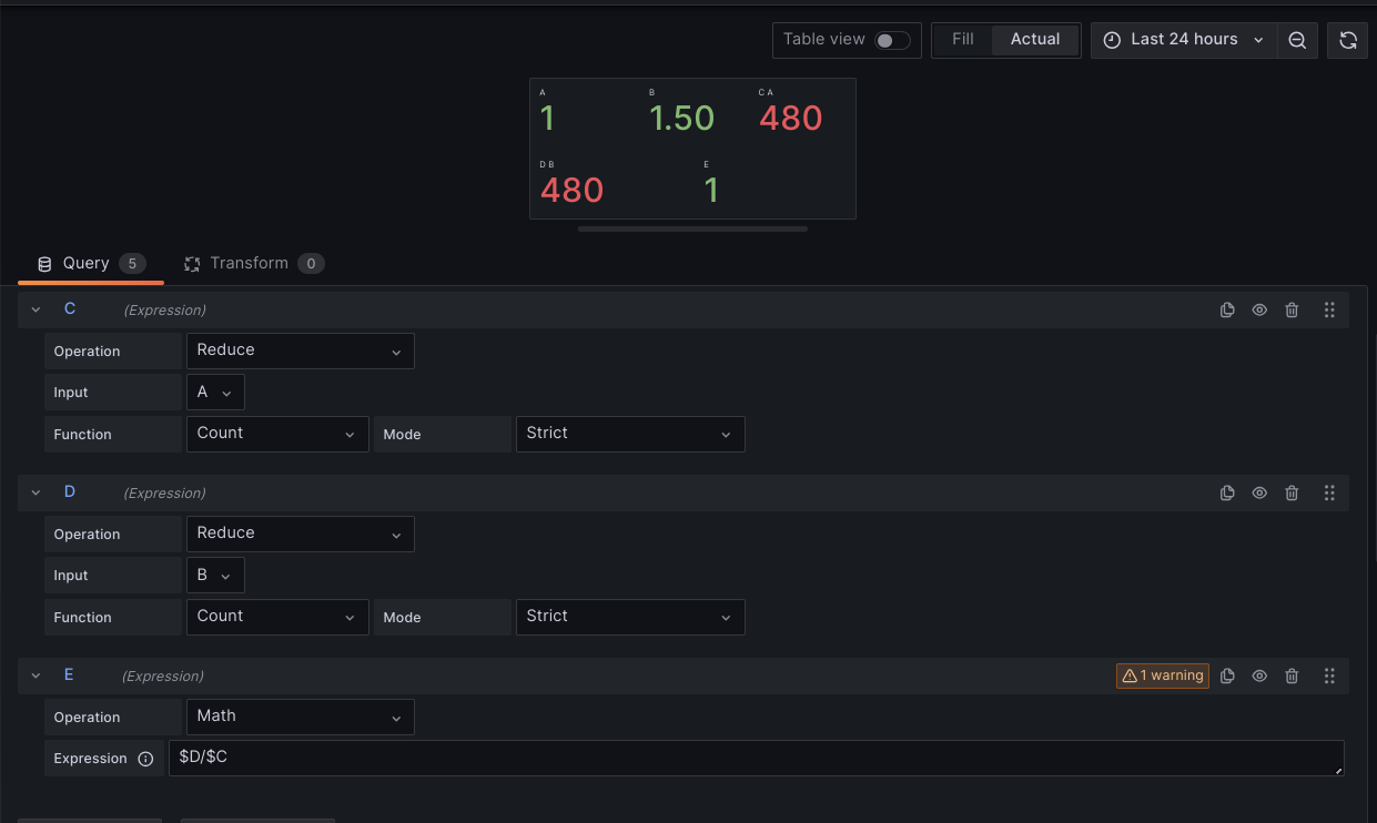

Instead of doing Transformations, I created expressions to do the COUNT of A and COUNT of B, then did an expression to Divide the values. It works in that there are no errors, but it’s now a single value that must be displayed via a stat panel (instead of the original time series chart). If that approach works for you, you could probably continue on with this approach.

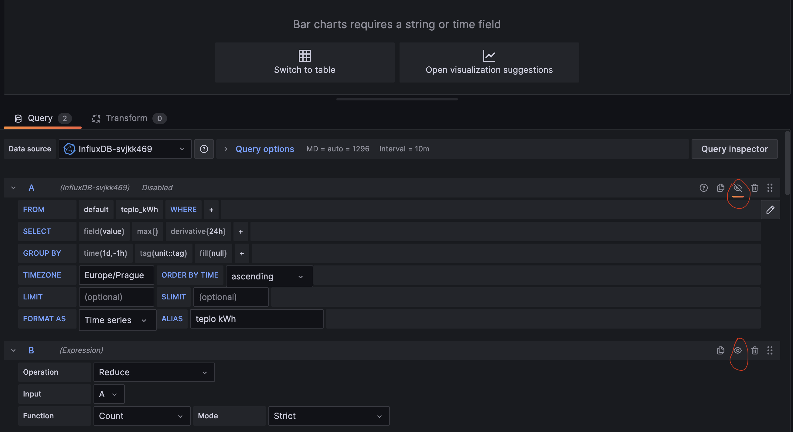

thanks a lot for your effort. Unfortunately your approach does not work for me. Expression (Reduce A Count Strict) does not return any value:

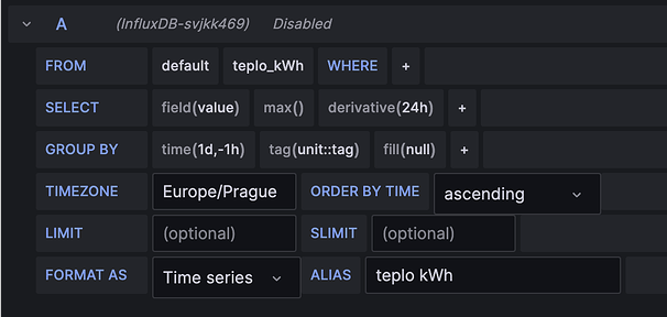

Could you help me/direct me how to accomplish this task with InfluxDB? The actual query is:
SELECT derivative(max("value"), 24h) FROM "teplo_kWh" WHERE time >= 1697290174337ms and time <= 1697894974338ms GROUP BY time(1d,-1h), "unit"::tag fill(null) ORDER BY time ASC tz('Europe/Prague')

My pleasure. Here is the original Query A:

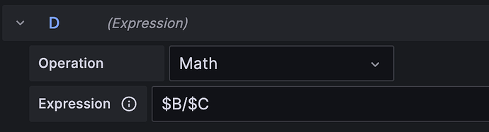

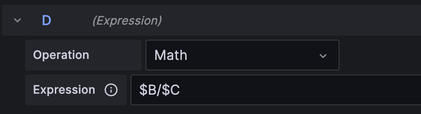

At this point adding Expression D to divide “sum_power_of_all_devices” by “number_of_devices” to get the average power consumption per device per day:
And it works so nicely!
