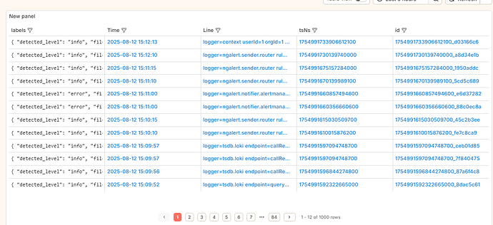

I receive logs and visualize them using Loki.
For this, I use table panels. Can I configure the panel so that when I click on a log line, I get the raw log? Is there any way to implement this? Thank you in advance for your response.

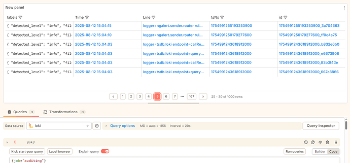

Step 2. Create a two-panel dashboard:
a. The first panel displays all logs using the Table visualization.
b. The second panel shows detailed information for individual logs.

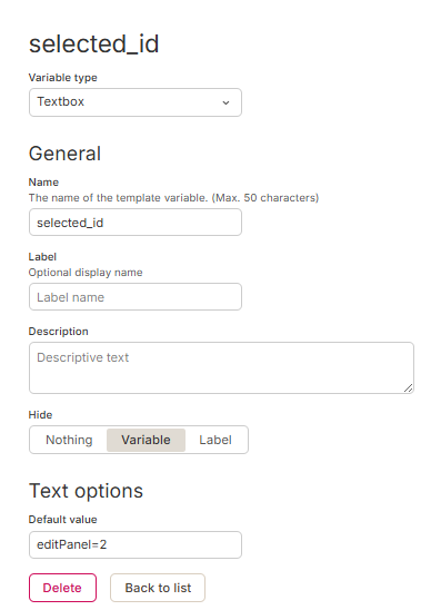

Step 3. Create a variable.
Step 4. In the first panel, add a data link that filters the logs based on id and shop in the output.

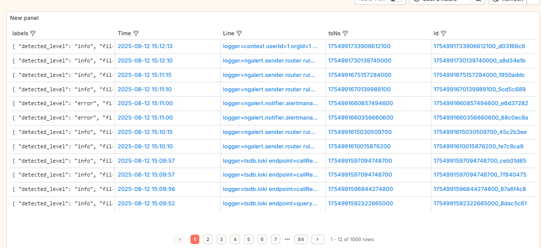

Final output :-
