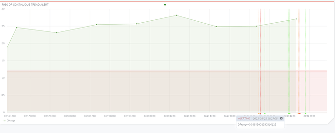

As you can see from the figure, the alerts are triggered when the value is actually beyond the threshold. The actual value is around 2.5, but the alarm said that the value is 0.036.
Attached is my query. I took the difference between maximum and minimum value of each day.

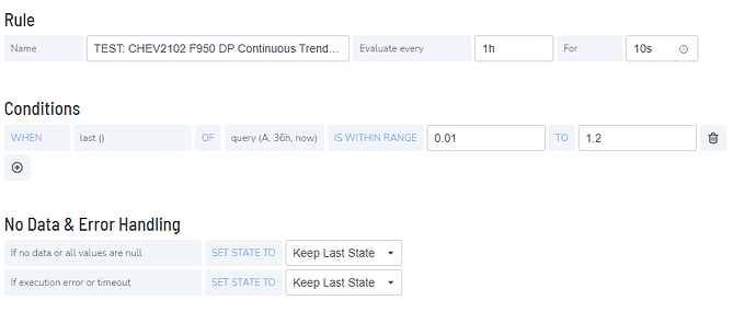

My alert setting:
