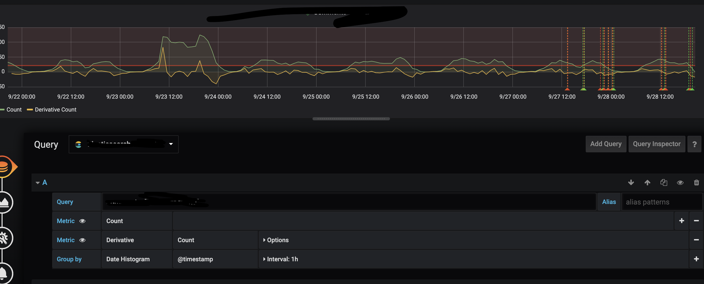

Currently, I am having metrics and graph like this and i want to apply alert on yellow. How to do that?
As you can see here i have only Query A present here.
Just select the eye picture beside Metric Count, then you will have only Derivative metrics show, then build the alert
