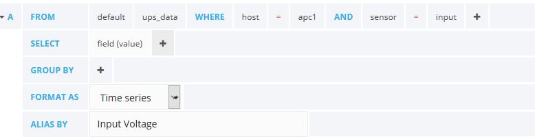

Just a newbie to Grafana, I prepared some script to monitor UPS voltage changes, and prepared some rule to alert changes. But seems alert even cannot report normal states, did I done any wrong on data feed or alert rule?
The value returned from query is 219 and you condition says below 200
Yes, but why the alert cannot report normal state at this moment?
It only reports state changes, so will only send notifications (if you configured those) when going from ok to alerting or from alerting to ok
