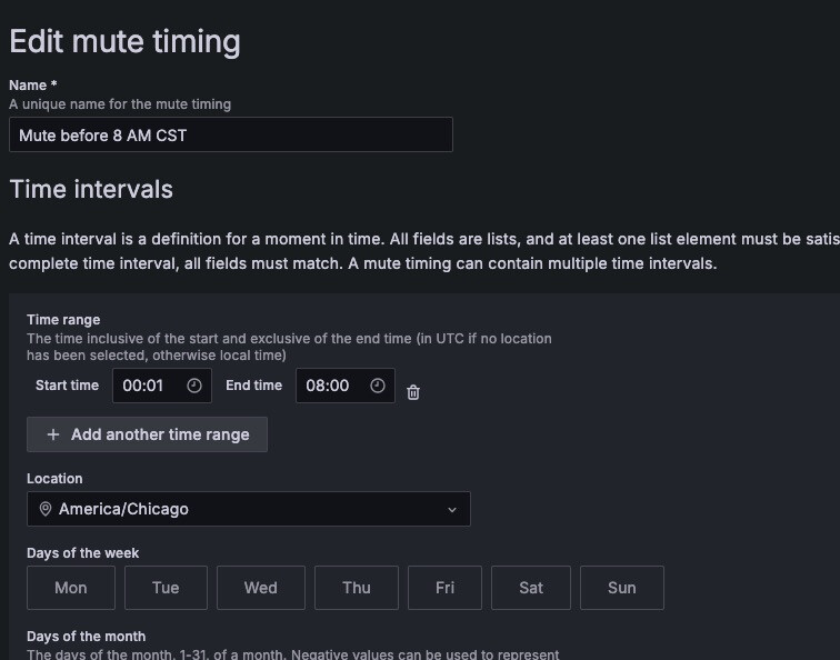

I am trying to Mute alert notifications for a time interval, but it seems it’s not working, since the alerts are still firing.

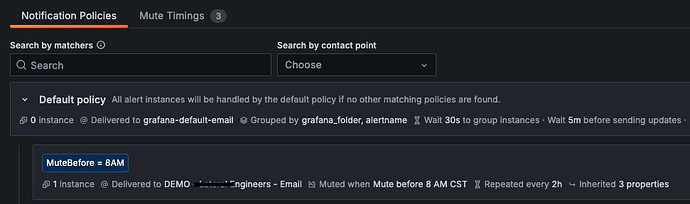

I have set up Notification Policies, that use Mute timings and then routed the alert to notify via the notification policy. The routing works, since I clicked Preview and the routing confirms it uses my policy.
So why does grafana ignore my policy and mute timings?

Mute timings only suppress the notifications. Alert are evaluated and routed to specific policies.
For a more details, check out the intro about the distinct notifications components and architecture of Grafana Alerting, which decouples alert evaluation and their notifications.
