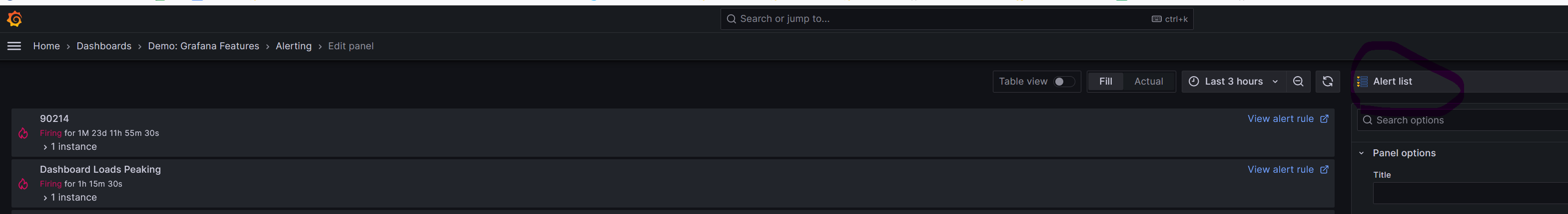

Here’s my actual alert list panel, please take a look.
Hi @tpham179
After testing, I found out that the “view alert rule” button is an available feature from Grafana v9.5.0. Once you upgrade, you should see it displayed.
Thank you so much I appreciated your response, have a nice day!
