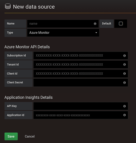

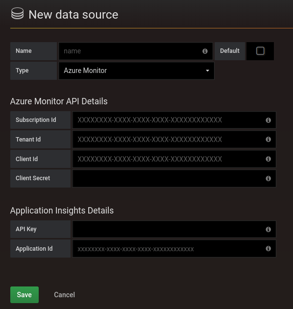

This is what the config page looks like and it is these values (tenantId, clientId etc.) that are used in the route spec in the plugin.json file:
