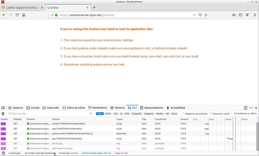

Following official Grafana Nginx reverse proxy guide I have configured my server block and grafana.ini with a subpath. When I browse to my grafana url, everytime I get this message:
If you're seeing this Grafana has failed to load its application files
1. This could be caused by your reverse proxy settings.
2. If you host grafana under subpath make sure your grafana.ini root_url setting includes subpath
3. If you have a local dev build make sure you build frontend using: yarn start, yarn start:hot, or yarn build
4. Sometimes restarting grafana-server can help

Screenshot with response and network debug:
Plase, could you guide me what I’m doing wrong??
