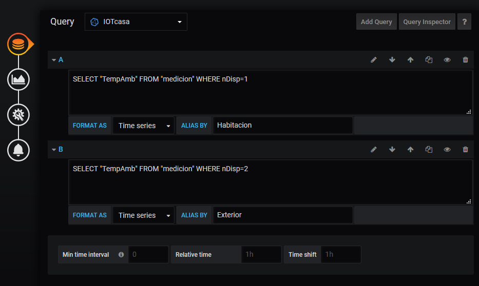

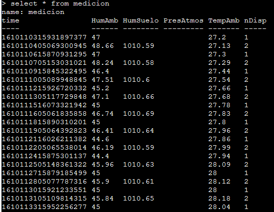

Here is the scenario (in this days redo all the structure of the db). I have a DB whit a measurement “medicion” (it translate as measurement) every entry in that “table” has the next fields.
As you can see i have a column that is device number (nDisp) and other 3 columns that are diferent values from the device.
The problem.
I want to show in a single graph all the temperatures from the different sensors like
this
Today i am making this whit 2 querys like this
I want to know if i can do this but whit only one query and if tomorrow i add a new sensor, the data of that sensor is showed in the graph without modifying the query.

The problem was that i was using fields instead of tags for the nDisp number.
When you use that grafana (or maybe influx i dont know) didnt separate well using GROUP BY in the query.
Once i rewrote all the NodeRed flow and drop the database, the nDisp its now a tag that can be indexable using GROUP BY and can be separated by grafana, when i add a new device in the set it automatically adds the data to the graph.
