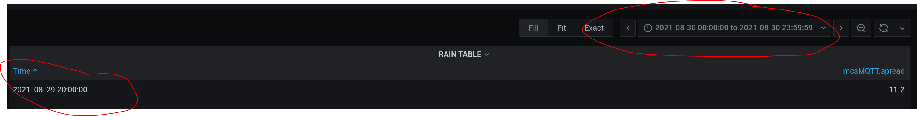

1d spread query - wrong timestamp (previous day 20:00 ?)
I built a query to get a daily spread value (so from midnight to midnight)
My query works as intended and the result is accurate.
However for some reason, the associated timestamp is the previous day at 20:00? why is it and why 20:00? is this timezone related and how can I change this so I get a timestamp within the spread period ? (tried playing with “tz” unsuccessfully)
When I check distinct values they all have correct timestamps within the period.
SELECT spread(“value”) FROM “mcsMQTT” WHERE (“device” = ‘!WEATHER_Acurite-Rain899_rain_mm’) AND time >= 1630296000000ms and time <= 1630382399000ms GROUP BY time(1d) fill(none);

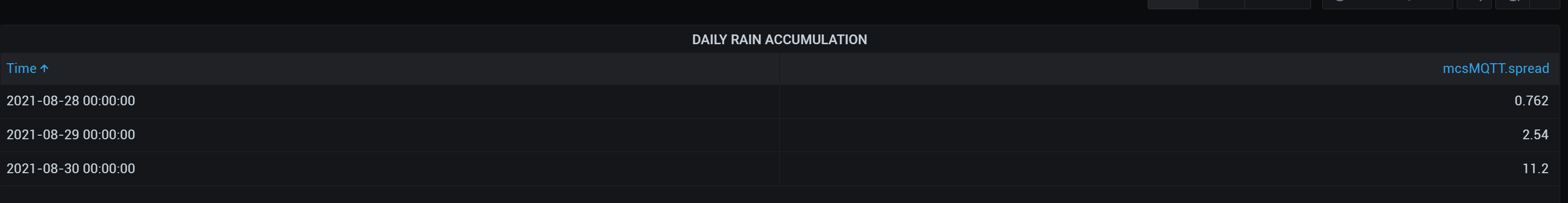

If you can’t get the tz() clause to work, you can also add an offset to the GROUP BY time() clause - see Explore data using InfluxQL | InfluxDB OSS v1 Documentation. It’s a bit more “manual”, but should yield the same result.
Not sure where the bug is as I’m using 1.8.4…
Anyways, thank you very much for that second option, works perfectly!
However, I guess this would need to be manually adjusted twice a year for DST ?? not good…
Any other potential troubleshooting to look into?
SELECT spread(“value”) FROM “mcsMQTT” WHERE (“device” = ‘!WEATHER_Acurite-Rain899_rain_mm’) AND time >= now() - 7d GROUP BY time(1d,4h) fill(none)
