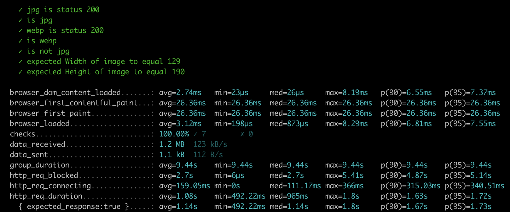

time="2022-09-06T11:49:17Z" level=error msg="Exception raised in test \"TEST NAME\". Failing the test and continuing. \nlaunching browser: exec: no command" source=console
This is locally, you see browser specific items below the green.
This is docker, you see the exception being raised that it can’t launch browser. Also, There is no browser content below.
From the screenshot
So there is definitely a difference that I am missing.
