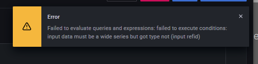

I am trying to set an alarm where if I don’t hear from a IOT thing within a certain time I want the alarm set. I have a query that works at AWS Timestream but I can’t get the query result in the right format. I get a super cryptic error message:
“Error
Failed to evaluate queries and expressions” failed to execute conditions: input data must be a wide series but got type not (input refid)"
Image 054
What is a “wide series”? How do I make sense of this error message?

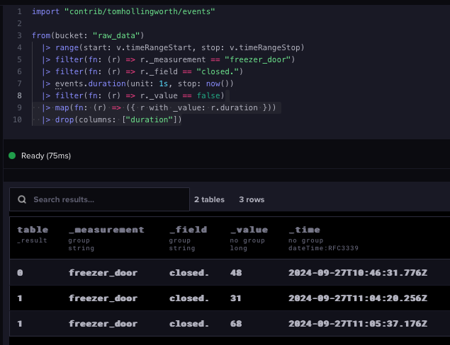

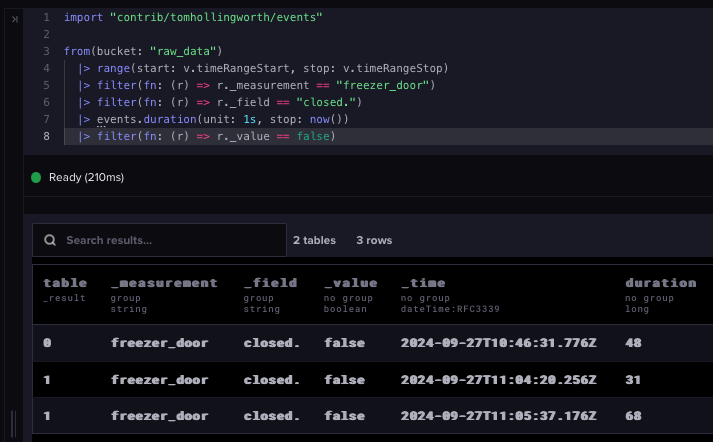

Since I stumbled also on this OLD topic I just wanted to log my solution here for the record. My data source is Influx, don’t know what the original’s source is though.
Main issue is: _value must be an INT, not STRING
=> So to solve I mapped the result I was looking for (duration) to _value
(I think if your datasource would be SQL you can use ::decimal to convert)

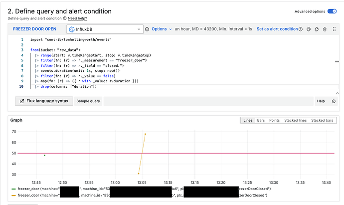

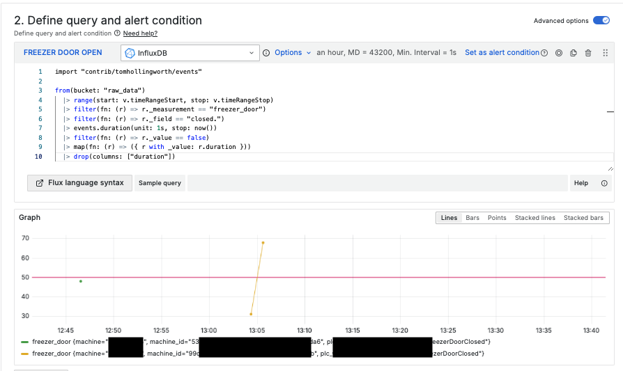

Take a look to the difference in the 2 screenshots one without map() and the other having duration mapped to _value.
Screenshot 2024-09-27 at 13.35.15

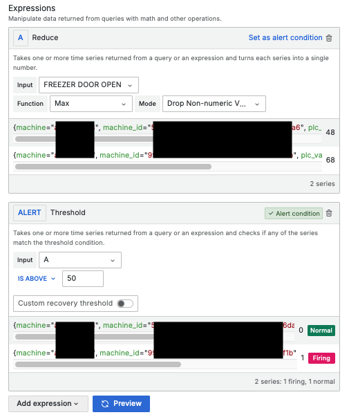

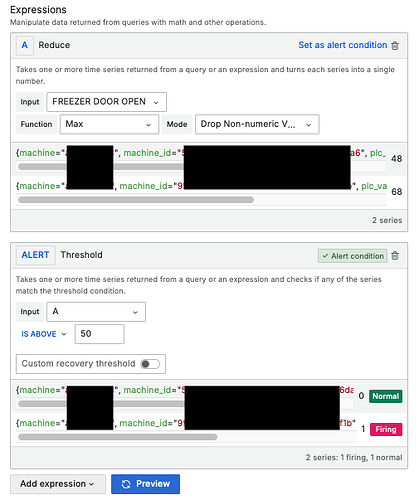

If I use it like this in Grafana alerts then I perform a Reduce + Threshold and it should show series with the results.
Hope this helps anyone who stumbles upon this! :melting_face:
