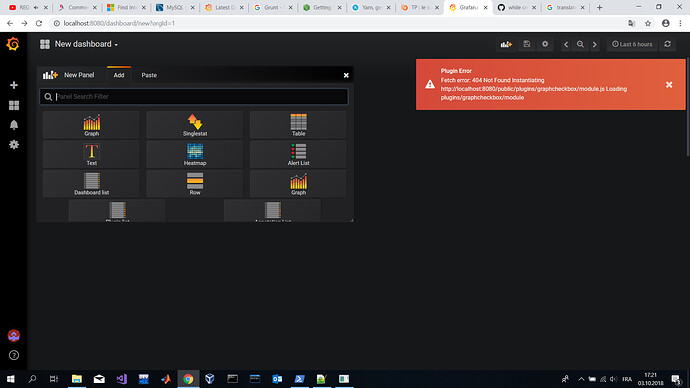

I want to use grafana to display some technical datas from an assembly line. In addition, I want to display some breakdown events. There will be many type of breakdown, so I want to select part of them or all of them to be figure out on the graph with simple check box (button). So I want to create my own plugin starting from the already existing graph folder, located in (\grafana-5.2.4\public\app\plugins\panel). I copy past it on (\grafana-5.2.4\data\plugins). I changed the id on the plugin.json.

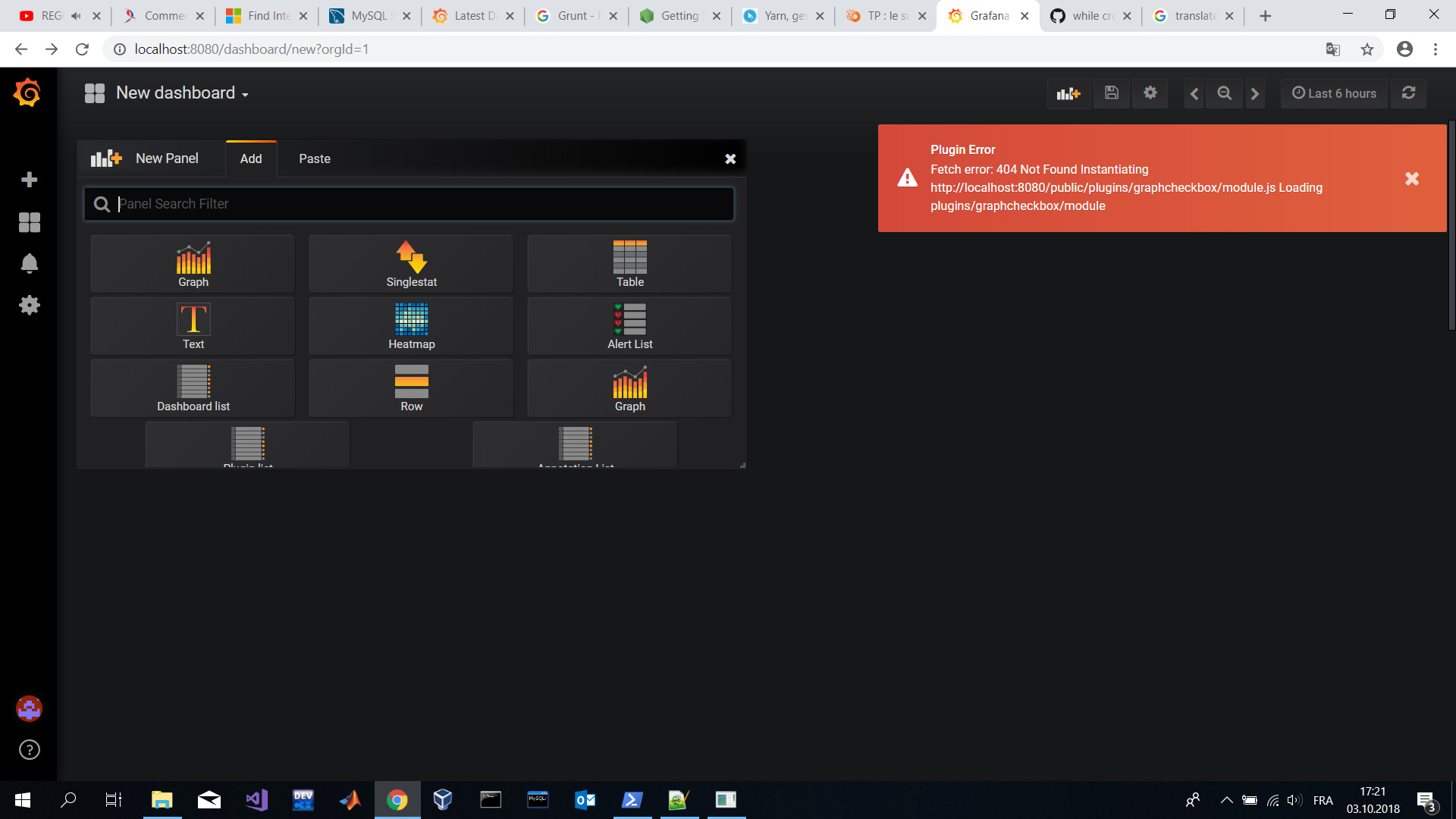

When I want to add a graph from the copy I get this error ,
Plugin Error
Fetch error: 404 Not Found Instantiating http://localhost:8080/public/plugins/graphcheckbox/module.js Loading plugins/graphcheckbox/module
I dont understand what’s wrong here :confused: Some one for help me ?
