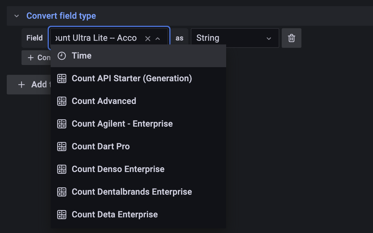

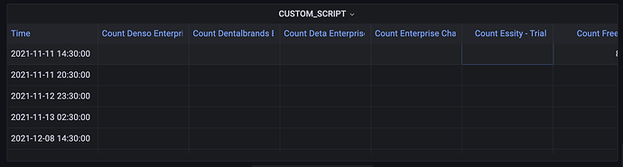

Thanks, @anon70503803 I tried using Transform to change the data type of the field, but in my case, all data is showing as a new field (column)

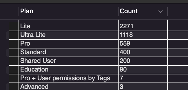

Plan should appear as a column, having the plan names as row values.
The same result in MySQL looks like
Screen Shot 2022-05-25 at 8.36.06 AM
but in Grafana, it is combining both count and plan columns to create new columns.
