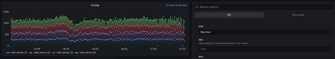

Did you try this?
BEFORE:
Standard option → Unit → Misc → Number:
AFTER:
Standard option → Unit → Misc → Short:
Yep I did and this is what’s being displayed.
While it’s supposed to display 7.49 P
Quadr for Quadrilion? It works, but that’s not really scientific.
