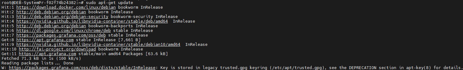

Encountered Error:
Upon executing the command to install Grafana, the following error is displayed:
root@DEB-SystemPr-f02f74b24382:~# sudo apt-get install grafana
Reading package lists... Done
Building dependency tree... Done
Reading state information... Done
Package grafana is not available, but is referred to by another package.
This may mean that the package is missing, has been obsoleted, or
is only available from another source
E: Package 'grafana' has no installation candidate

root@DEB-SystemPr-f02f74b24382:~# sudo apt-get update --fix-missing
Hit:1 https://download.docker.com/linux/debian bookworm InRelease
Hit:2 https://packages.grafana.com/oss/deb stable InRelease
Hit:3 http://deb.debian.org/debian bookworm InRelease
Hit:4 http://deb.debian.org/debian-security bookworm-security InRelease
Hit:5 https://dl.google.com/linux/chrome/deb stable InRelease
Hit:6 https://nvidia.github.io/libnvidia-container/stable/deb/amd64  InRelease
Hit:7 https://nvidia.github.io/libnvidia-container/stable/debian10/amd64  InRelease
Hit:8 http://deb.debian.org/debian bookworm-backports InRelease
Hit:9 https://apt.grafana.com stable InRelease
Hit:10 https://apt.grafana.com beta InRelease
Hit:11 http://fai-project.org/download bookworm InRelease
W: https://packages.grafana.com/oss/deb/dists/stable/InRelease: Key is stored in legacy trusted.gpg keyring (/etc/apt/trusted.gpg), see the DEPRECATION section in apt-key(8) for details.

Exact same problem on Debian 11 (bullseye)
@sfuke removing the beta entry from /etc/apt/sources.list.d/grafana.list and running apt update & apt install grafana should do the trick
