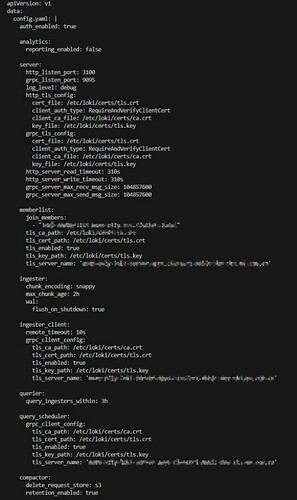

Here is the configmap of the loki stack:

Your configuration looks good to me. You mentioned same time today, does that mean the errors are intermittent and only happen at a specific time?
