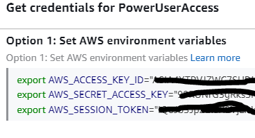

I stored test data file in S3 bucket and tried to access uding s3client.
I used AWS JSLib for K6 to configure and connect to S3 client. It could not find bucket in a SSO enabled AWS account which requires AWS_SESSION_TOKEN.
The AWS Config doesn’t have a provision to pass Session Token alongwith Access_Key_ID and Secret_Access_Key which is mandatory for SSO enabled accounts.

Need to send all three parameters for connection.
Is there any way I can pass the session Token?
